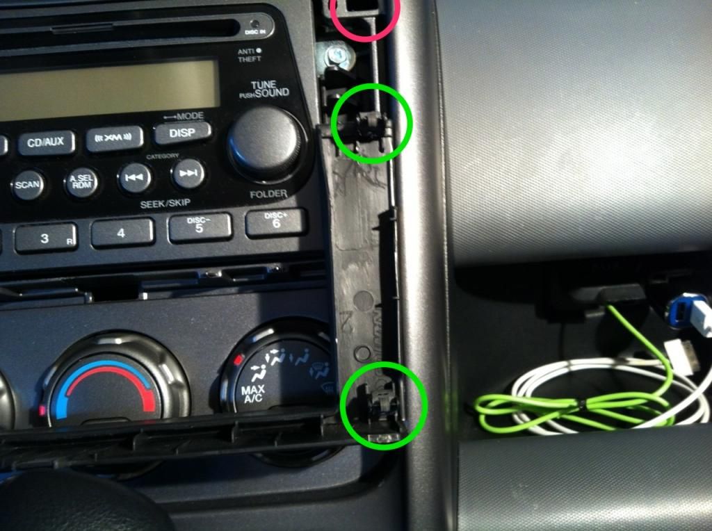

Here's a photo of the radio trim piece removed and turned around so you can see the back.
Two of the clips are circled in Green and the top right slot the receives the clip is circled in Pink.

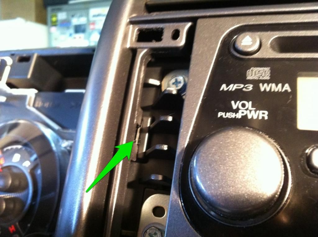

With the radio trim removed you'll notice there are some angled ribs of plastic on either side of the radio.
Also not there is a small notch on the trim piece near these angled ribs on each side of the stereo.

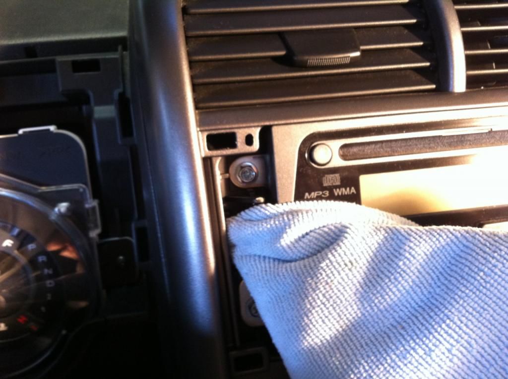

I used these notches to pry off the center dash trim. I covered a large and fairly long flat blade screwdriver in a cloth and pried the trim with the length of the screwdriver blade resting on those plastic ribs.
I pried a bit on one side and then the other which release some of the upper clips. I then repeated the process on each side until all of the upper clips around the center air vents released. With the top clips released, I was able to simply pull off the entire trim piece.

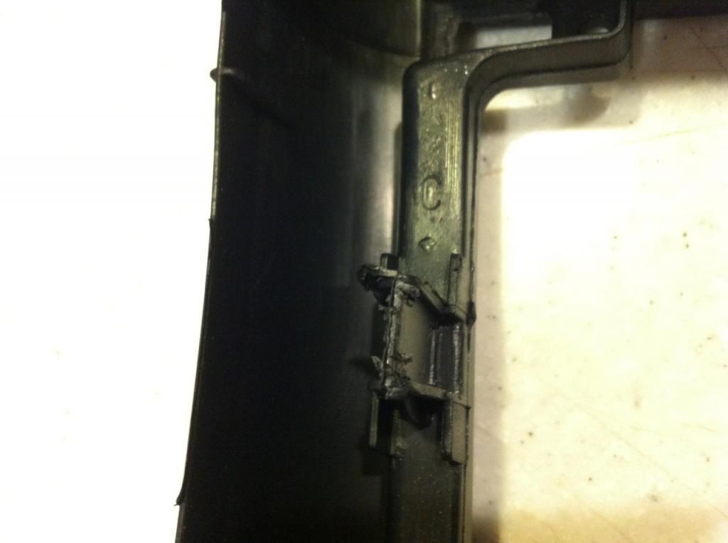

When I pulled the center trim off the dash I lost a couple of the metal retaining clips. They pulled off the plastic tabs behind the trim piece and ended up somewhere inside the dash.
Here's one of the plastic tabs.
And here's what one supposed to look like with the clip installed.

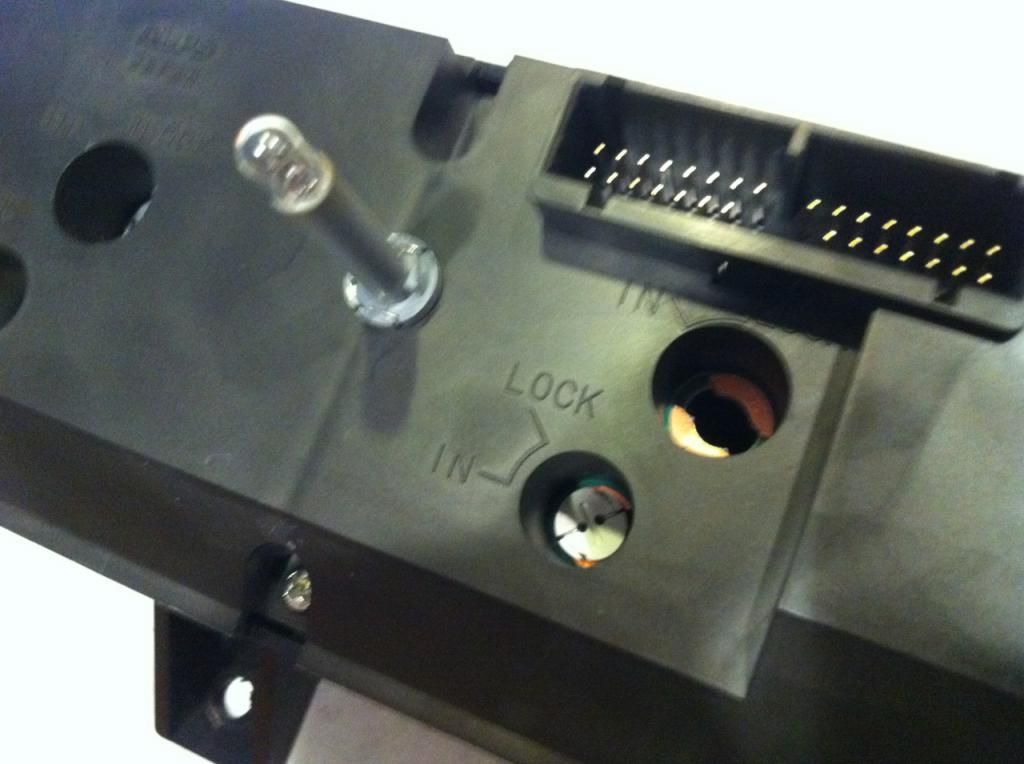

When I had the center dash removed, I also removed the HVAC control model from the dash. This isn't required to replace the bulbs. I just removed it to make taking these photos easier. Here is the center dash with the HVAC module removed.

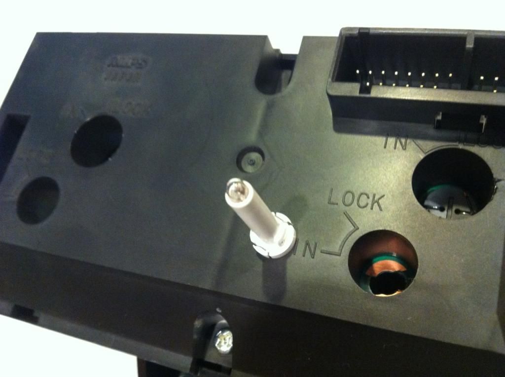

Here is the back of the HVAC module. Here are six lamps total on the HVAC module. Three for illuminating the knobs, the fan speed, the temperature, and the mode selector. Then there are three for illuminating the buttons, the recirculation button, the AC button and the rear defogger button. All you need is a small flat blade jewelers screw driver to remove the bulbs.

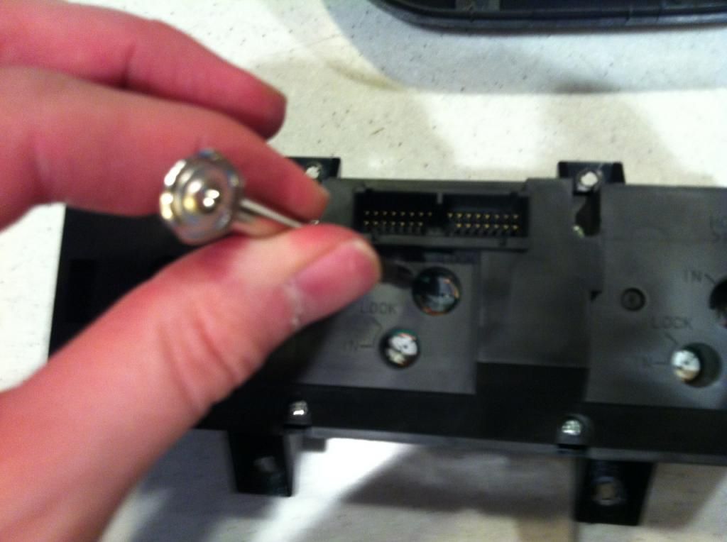

Here is one of the knob lights removed. Notice there are instructions molded right into the plastic.
Here is one of the button lights removed. Notice the button lamps are different than the knob lights.
I was having intermittent issues with the HVAC knob lamps. The one I had the most problems with was the center temperature knob. I replaced that bulb and re connected the HVAC module to the wiring harness in the dash and found that the lamp behind the mode selector knob was out.
What I noticed when I replaced the lamp with the new one was that the old lamp turned very easy in the socket. When I installed the new bulb though, it was very tight and tough to turn with the small jewelers screwdriver. I decided the reason I was having intermittent problems with these bulbs was because the connection was loose. Instead of having to deal with this issue again. I ordered two more bulbs from the dealer and replaced the lamps behind all three HVAC knobs. When I installed the other two bulbs they were also very tight. I don't think I'll have problems with these bulbs anymore.
Another thing I discovered is that it can be hard to tell if the bulb you replaced is working or not if you're working in the day time. I found it was easiest to look at the lamps from behind. You should see distinct light coming from the lamp socket if the bulb is working.
Be sure you see a bight light from the tiny holes in the back of the lamp. If it looks dim, it might just be light from another lamp spilling over.

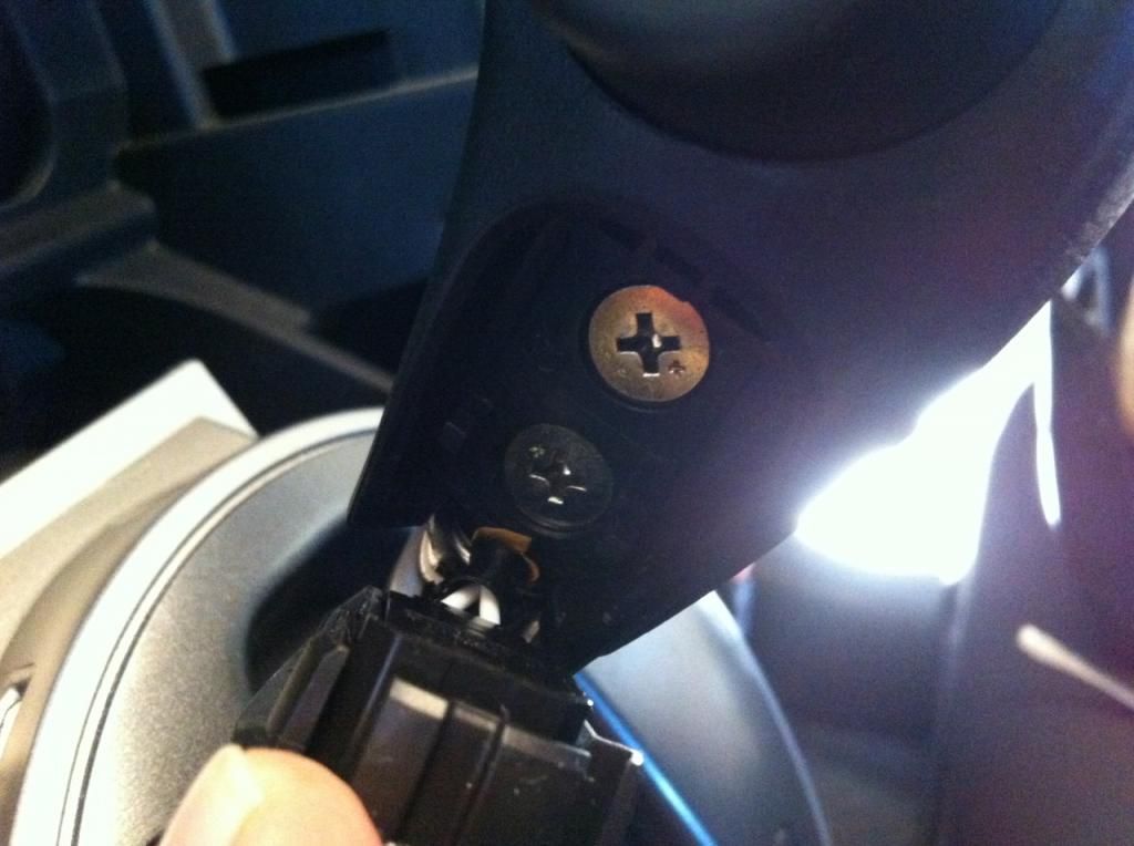

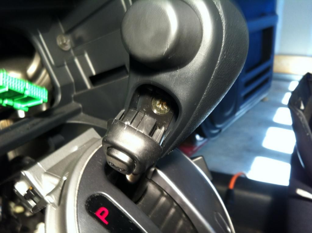

First carefully pry the overdrive button off with a jewelers screwdriver.
Then remove the two screws holding the handle in place.
Then lift the handle off, making sure you don't loose the button or the spring behind it.

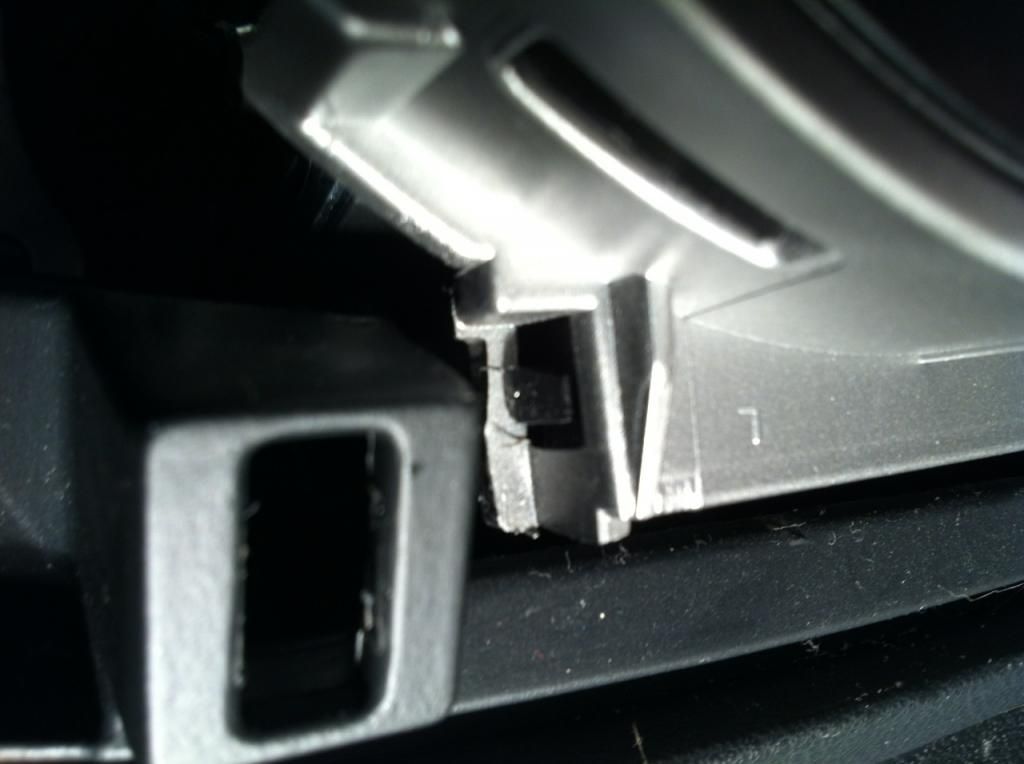

Here is a picture of the top clip on the gear shift lever surround.

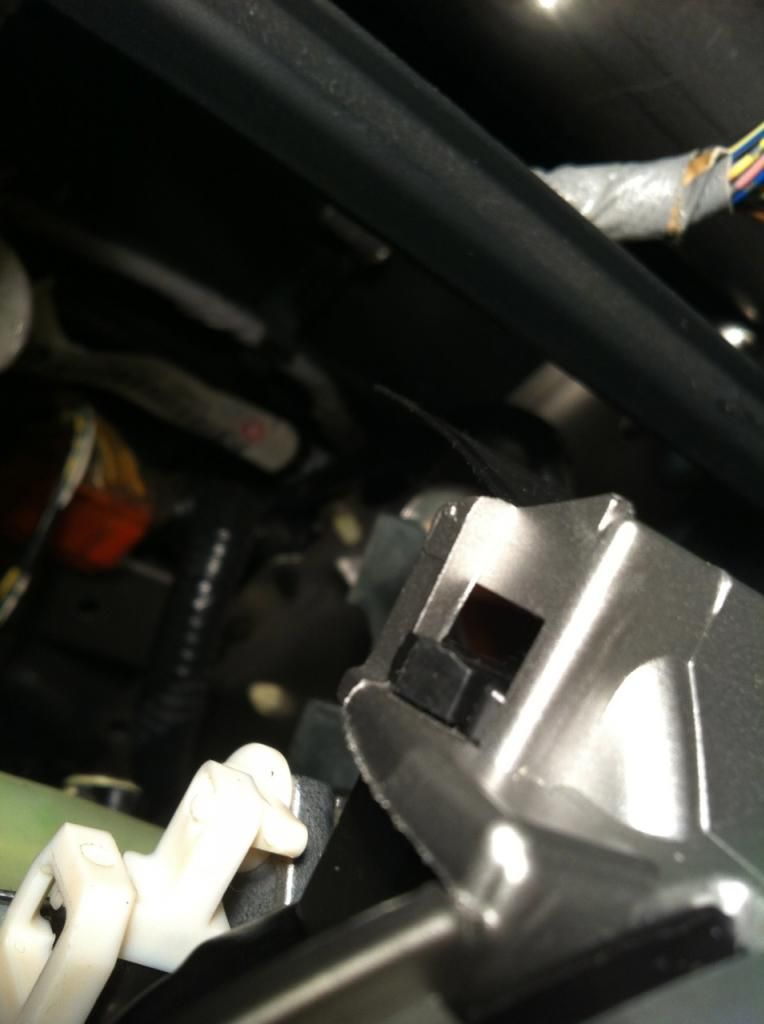

And a shot of one of the bottom clips.
Just pry outward a little bit at each tab to release this trim piece and then lift it over the shifter lever. You might have to loosen the wire that leads to the lamp (if it's still attached) before you can slip the trim up and over the handle.

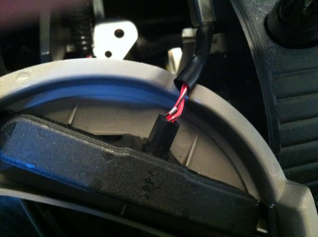

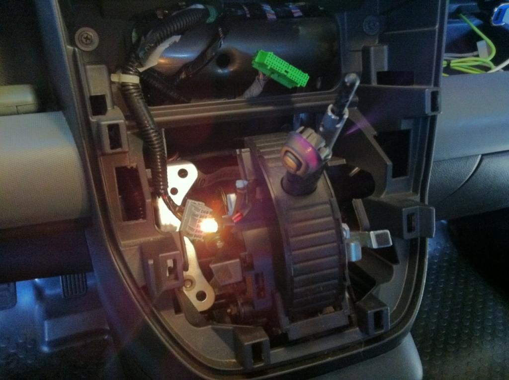

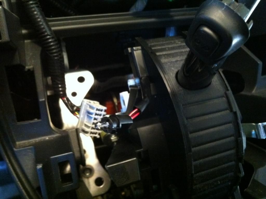

With the trim piece removed, here's a shot of the back of the gear indicator and the wires leading to the lamp socket.
You remove the socket by turning it 1/4 turn and then pulling it out. This bulb is a tiny grain of rice type bulb that plugs into the socket.
Dead blub
Working bulb

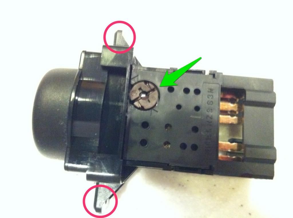

The hazard switch is removed with the center dash by disconnecting the gray wiring harness connector pictured above. You won't be able to remove the center dash from the car without disconnecting the hazard button and the HVAC controls. I removed the hazard button from the center dash to make it easier to take these photos but you can probably replace the bulb without removing the button from the dash.
Here is the hazard button removed.
Two screws go through the tabs circled in Pink to hold the button to the dash. The lamp is indicated with the green arrow. Here again, you just need a flat jewelers screw driver and a 1/4 turn to loosen the bulb from the socket. I had to pry on the bulb a bit to get it to come out of the socket.
