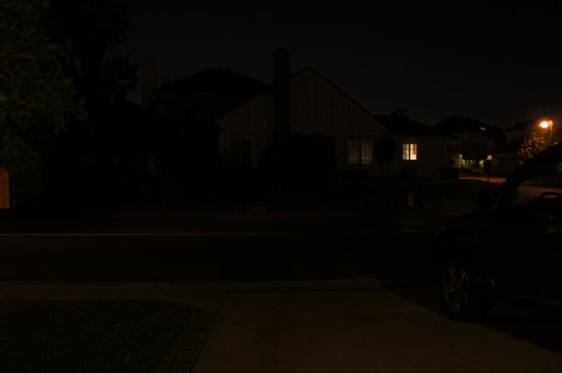

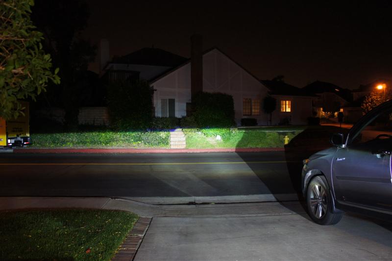

Just the normal beam pattern. When you get out to 150 feet you don't get that much light intensity... but that was to be expected. To my surprise there was still light being projected out that far.

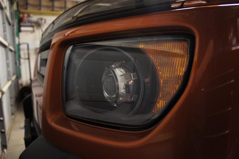

What did you use for a shroud? Im going to the hardware store tomorrow to look for stuff and get the necessary mounting hardware.
1,657 Posts
I attempted to use an Ace Hardware 2" flange which would have probably worked out nicely, but decided against it in the end. It didn't quite slide on easily - really needed a 2 1/4" to clear the metal lens holder if it exists. In the end I just left it bare but painted the entire housing and the base of the projector with BBQ black paint. You can remove the metal on the front and the lens will come off. Taped up the inside and painted the rest. You can't tell unless you get up close and take a look. Head to the forums on www.hidplanet.com and look in their "University" section (I believe) to find a sticky shroud thread. Some people have come up with truly creative ideas.

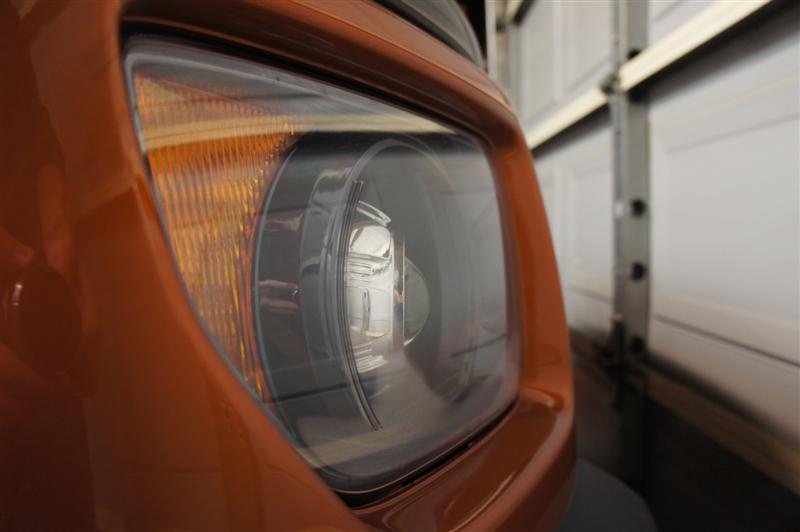

Im getting ready to cut up the reflector bowls to fit the new projectors. The TL projectors look so much bigger than the other pictures posted here.

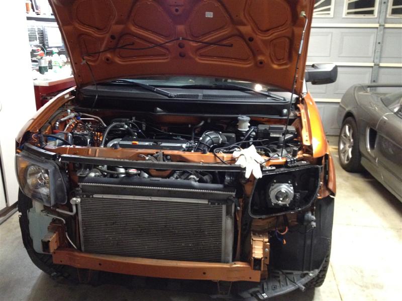

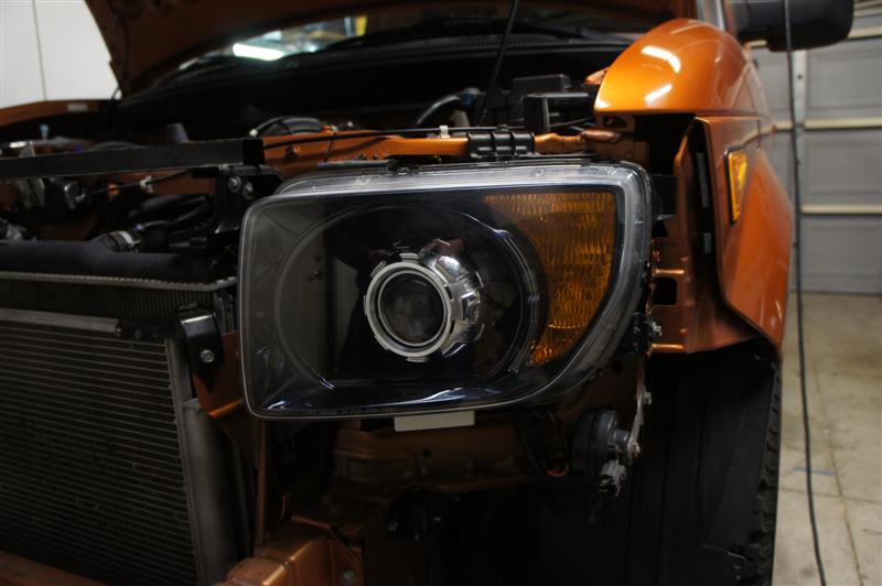

Making some progress and its GREAT so far. I'm taking a different approach from the norm. Instead of modifying the reflector buckets to accept the projectors I'm making custom brackets. This effectively pushes the the projector out an additional 1.5" giving better light output. Here's some teaser pics of my progress so far

Also finished my lights today!

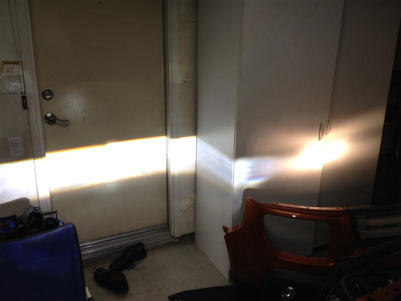

Projector is pushed out farther giving it the ability to throw light out the sides
Perpendicular shot showing how far the projector is really pushed out.

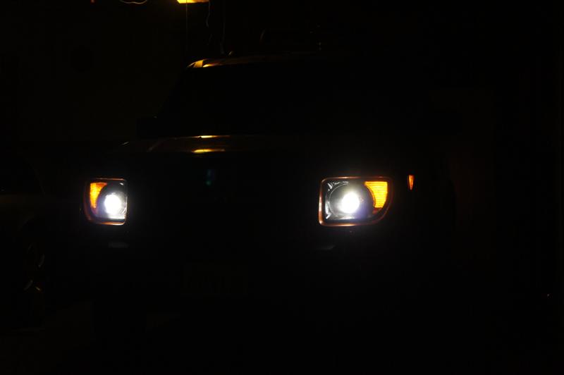

Before - No lights
After - with HIDS only. Pic was taken with same exposure as the "Before" pic!
