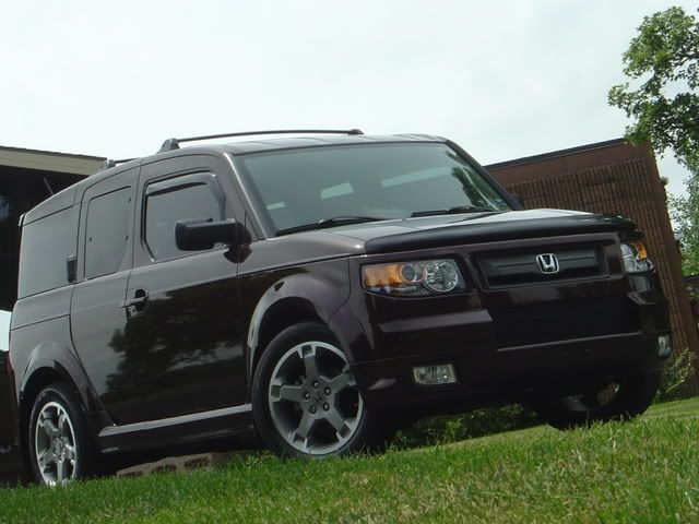

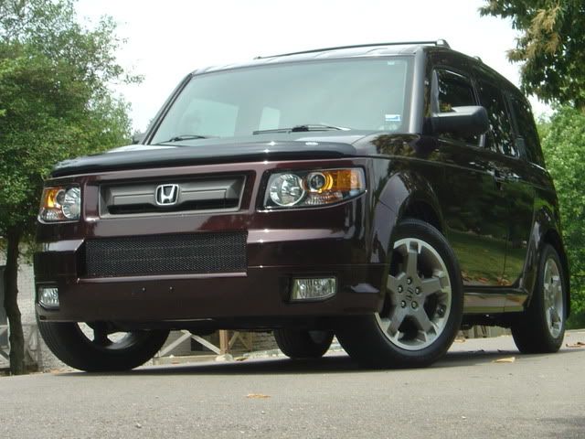

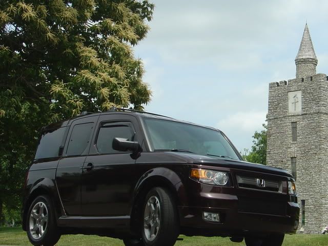

With hot days a head it was time to get my E ready for the summer. I got my GrillCraft grill gaurd installed and did a Mother's Clay Bar treatment for the first time. It was much easer than I anticipated and made a noticable difference. Below are a few photos I'd like to share. Also...just turned 30K miles and still luvin it.

awesome
Looks great...I am interested in the clay bar treatment but don't know how it works.How do you use a clay bar ?

Following a good strong cleaning of the E you begin by spraying a 1' x 1' area with the Mothers Showtime Spray. This makes for a very slick area for you to apply the Clay Bar. It didn't take a lot of elbow grease and the Clay Bar glided easily across the surface. You then follow up by buffing the area just completed. It took less time and effort than a full-on waxing and removes a lot of surface oxidization, swirl marks and light scratches. The treatment does not alter or affect the clear coat. I've read that you can do this up to twice a year. The kit comes with two full clay bars. I was advised to slice the clay bars into three sections. This way if you drop the clay bar on the ground you just pitch it and get a new section. You also need to kneed the clay bar after each application so that you are always working with a fresh piece of clay. I think there is enough in the kit to do three or four treatments. For around $20 it's an inexpensive investment that makes a difference.

After viewing my above photos they seemed a little dull and flat in releation to what the vehicle actually looks like, so I took the artisitic liberty of tweaking one of the photos in Picture Publisher (PhotoShop) to enhance it. I don't have a great camera to begin with (Sony Cyber Shot), but a little digital work made a difference. I like the result.
