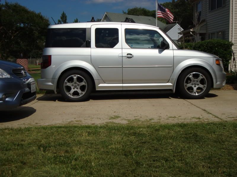

Hey, got some Eibachs and Koni Adjustables on my SC. I am pretty sure I am the first SC. Its been done on a EX that I know of. Anyways, here's a couple of pics.

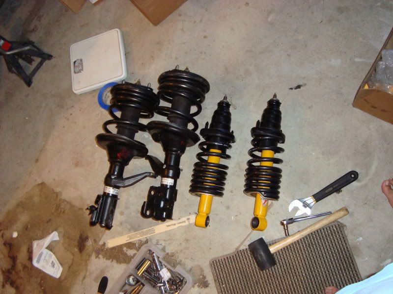

Lets see, I used the element eibach springs....Element strut bodies and top caps. spc camber arms. and rsx struts. only issue is on hard potholes I am getting a slight rubbing on the outside of the tire. checked the alignment and my camber is to the extreme of the postive side. so going to go more negative and should solve it. rides like silk now instead of an old wagon. still dialing it in a bit yet. front seemed a little soft on the way home from busch gardens so turned em up a bit.
Total cost to me:::
paided 130 for rsx struts to cut (you won't need so kinda doesn't count)
paide $80 for a set of 08 element struts
got a good deal for konis for 460 shipped on ebay (new)
got the eibach springs used for 180
traded my headunit for the spc camber kit...so $0
also spent 80 for a set of rear top caps just so I could keep my sc suspension in tact.
total suspension cost me too much, but it was an experience and a lot of extra was spent testing and playing. all you need it the camber kit, koni's and springs. the rest was for me to be safe by not cutting my struts so I could keep driving when I messed up.

Just an update. After rolling the fenders I am experiencing no rubbing. I am dialed in to 1.5 turns out of 2 max on the rear and about 1.25 in front out of 2 max. front is a little stiff and going to turn it down to 1.125 turns. does well with kids and dog and gear, changed my tie rod ends and all is steering better. took them apart too many times and they were way sloppy. about 800 miles on the system and only complaint is at full load up on big bumps I hit the bump stops in the rear. considering raising the travel .25" with the koni grooves on the outside of the shocks to compensate for this. ride is much much better quality. i used to rest my head against the rear seat rest and get a headache from all the pounding it did from the bouncy ride. no more. can leave it there and it might bump once in awhile on a pot hole. anyways, nothing has blown yet. will let you know if it does.

KONI'S failed. do not use rear struts. with full cargo both rear spring perches managed to slip over the c rings during highway driving. causing the rear of my E to drop another 3.5 inches or so. Making it undrivable. You have been warned.

Got her back. All running on stock again. Price tag was high since it happened outside of home and I didn't have much choice. it was too low for a flat bed so had to buy a stock suspension and have it put on. But, the failing part was the retaining clip that koni uses to hold the spring perch in place. had too much weight on it and it just rolled right out. perch and clip are destroyed. springs and damper look to be okay but not going to trust that I could repair it and something else would go bad. going to wait for some one to design a nice set with a welded perch. not a removeable one. actually found some sites where the clip rolled out on the cars they were meant for. seems to be a pretty shabby design. oh well, live and learn, it was a fun project.
