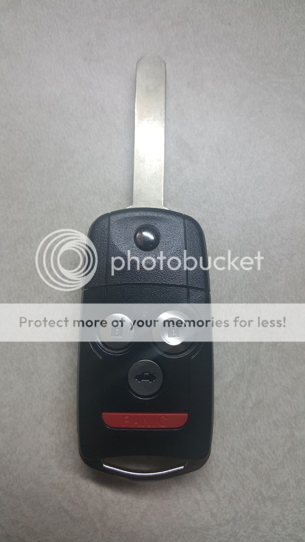

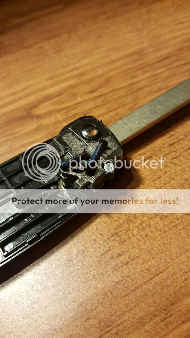

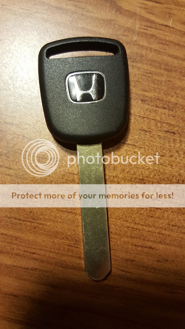

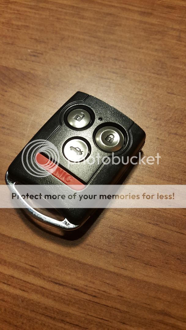

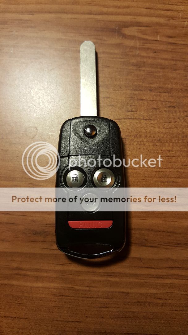

Materials Needed:
35111-SEP-307: Acura TL Memory 2 Remote. Depending on which is cheaper, 35111-SEP-306 can also be used. 35111-SEP-306 is the Acura TL Memory 1 Remote
35113-S9A-A01: The Blank Honda Element Transponder Key
35118-STK-A01: Acura MDX Remote Faceplate: Optional, although I believe it makes the final product look a lot more clean
I'm confused. So if a donor transponder from an Element key is going to be placed into the Acura flip remote, why not just place it directly into a MDX/RDX 2-button remote? Instead of a TL remote then swapping for a MDX/RDX faceplate.
