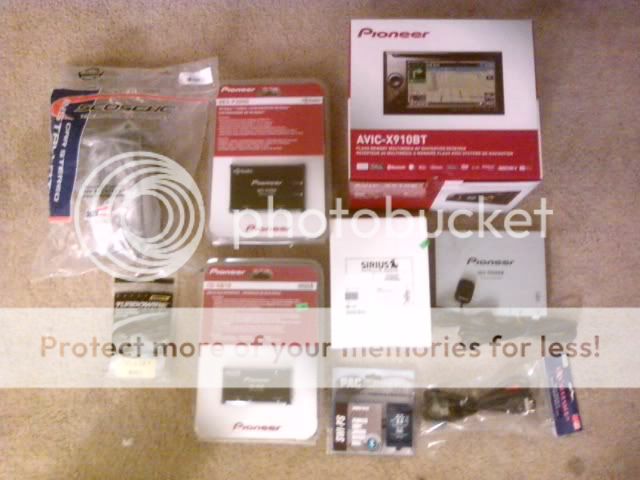

So i've been saving some money up for my navi screen....i was originally going to buy the Pioneer Z110BT, but ended up getting the AVIC-x910BT....i just couldn't justify spending more than a few hundred dollars extra for a screen that was 1.2" bigger :| ANyways....I have a huge install project ahead of me this weekend....Got the Navi screen going in, HD radio tuner, Sirius & XM Satelite radio tuners, Ipod dirrect video cable, video bypass, back up camera, PAC steering wheel controll module, and while i'm back there i'm going to be running my RCA's and remote wire so that I don't have to pull the deck out again when I install my amp and sub in a few months.... Well, it's a huge list of stuff to do, but the end product is gonna be sooooo worth it :grin: I'll be posting some pics soon as the install progresses.
