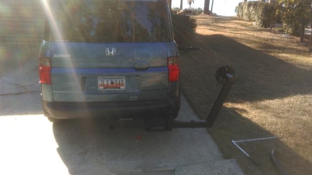

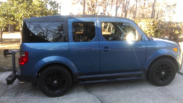

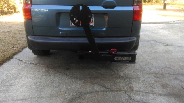

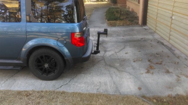

So I finally installed my Hitchgate Solo after about a month and a half of it sitting in my house. First impressions: It is extremely well built. Google Wilco Offroad (they also used to go by Hitchgate) and you'll find that they are a quality operation. Yes it is expensive, especially with add-ons, but if you can appreciate and afford high quality US made products - this just might be for you. If you only care about the bottom line and need a full size carrier - keep walking and order yourself a much simpler fixed/downward folding design.
Installation: I assembled it on my work bench and then tried to slip it into the hitch. It wasn't easy getting the wedge lock in there right while finagling the entire unit into the receiver. The instructions tell you to install the swingarm while the lower hitch section is installed in the receiver - I recommend to follow the instructions :). On my Reese receiver, I have to use the smaller 0.5" hitch pin hole. This means that I had to order a 0.5" locking hitch pin that is long enough to fit a 2" reciever.
It does sit a little low, but they do have a high clearance Solo in the works that looks like it sits about 4" higher than the regular Solo. If I knew what I know now, and if it was available, I'd order the high clearance version just because it will look better sitting closer to bumper height and will add a little extra clearance for the exhaust (it's close but not too close).
Now, here's what most people will skip directly to: The pics!

Yes, to stay legal in most areas you'll need to light up your license plate. I used 4 things:
1) The Solo's license plate relocation kit - I tried the Curt receiver hitch plate mount and it got in the way of the swing arm. Someone could probably attach it into the left side of the bumper if you don't want to buy the Solo's lprk
2) Element trailer harness w/4 pole connector
3) 4 pole trailer end connector
4) license plate light
All I did was solder the 4 pole trailer end connector's rear light and ground wires to the light's power and ground wires and sealed everything up. Then plugged that into the Element's 4 pole trailer connector.
