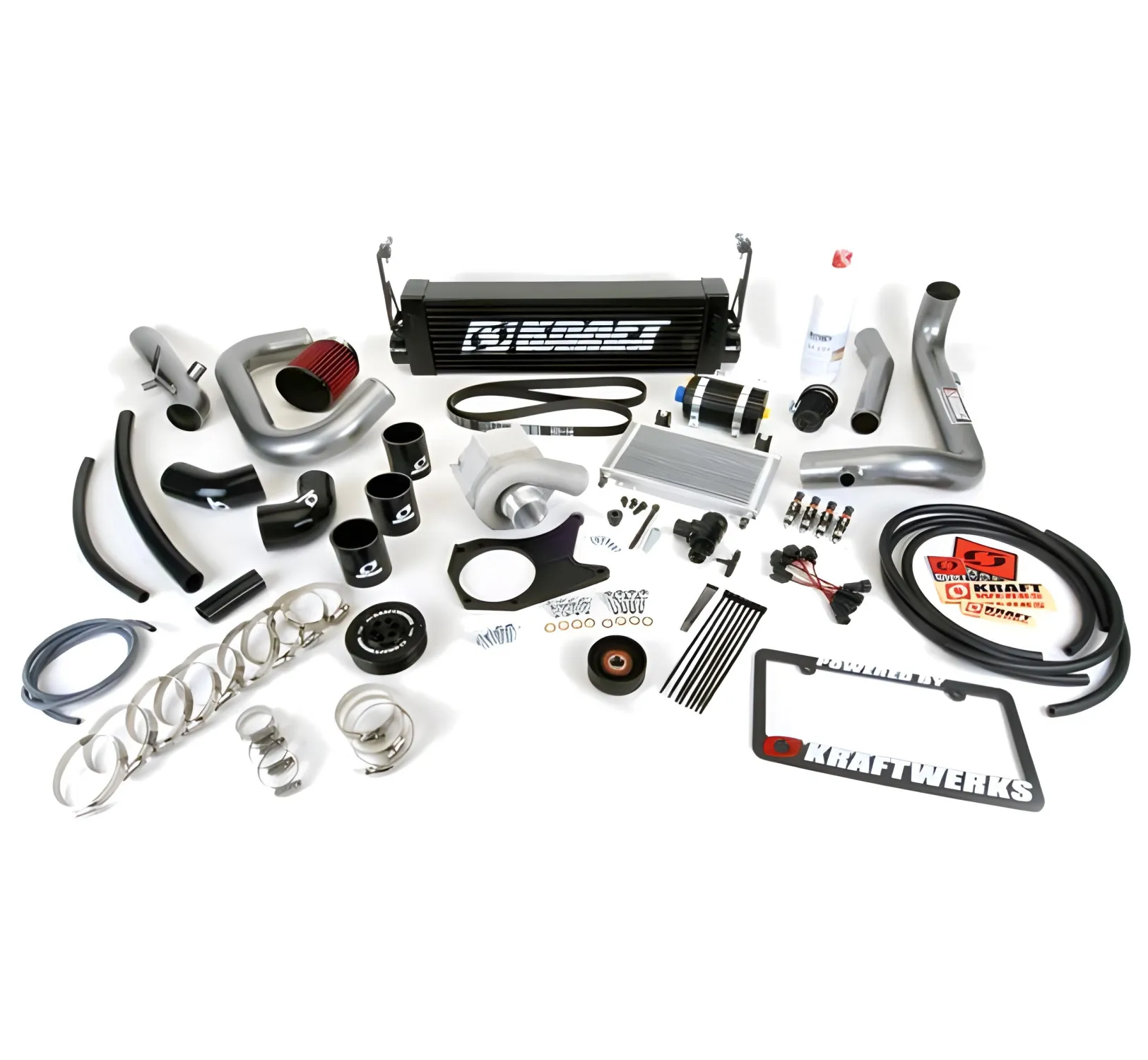

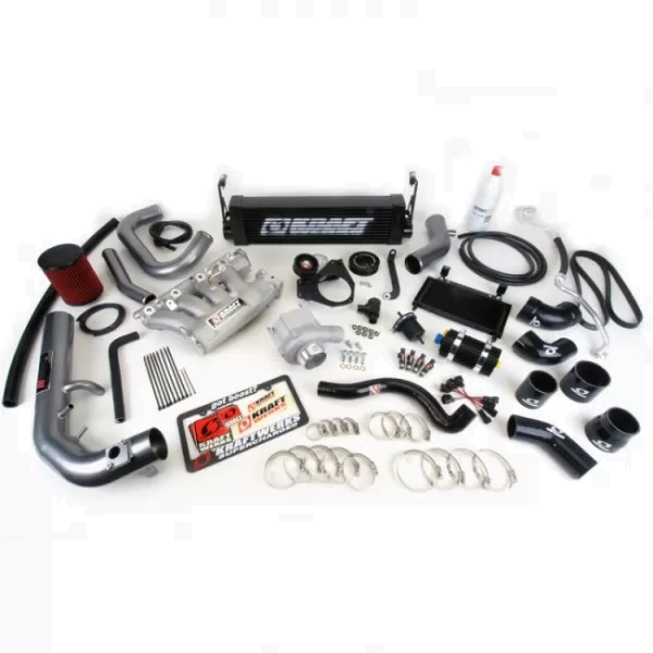

Yes, my understanding with the Kraftwerks kits are that they can fit, but one must remove the air conditioning unit. For me here in Houston, TX that is not an option! Also the Kraftwerks kit is not a drop in kit, it includes no piping and will require serious fabrication. What I like about the Merc Racing kit is that one can keep both their A/C and power steering and it looks like it will not require much fabrication, if any.
