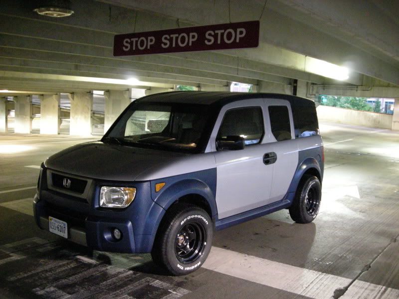

what ever posesed you to put black wheels on an RBM, just awful looking.
It's -44 forsure.If that -44 offset is correct, those are gonna stick out like 3 to 4 inches. If its a +44, should be about 2 in more than from if the -14 is correct, I think your gonna need some universal wide body fender flares.
2 reasons for the negative offset:what are the current wheel + tire specs? do u have spacers? Is there any rubbing? I was looking into this today and I wanted to get the silver ones that you have now (not chrome)..but i dont want to copy your style.
And I dont know anything about the offset...
I'm running a 225/70/15. The 15" wheel will fit with the right offset.alright cool..so the 15" wheel will fit with no issues. Thanks for filling me in about that, and you are right. Now I do know something about offset.
But I have another question. What about the tire size? I was thinking 225/60/15. Would that work? or would 235/60/15? I dont want to go any smaller on the sidewall. I am at 225/45/17 now and it throws off my speedometer by like 5-6 mph...
Yeah there's a good amount of stretch, helps out the look.I wanted to do 225/60/15 with 15x8 -19 offset. Does the tire stretch for you at all?
Never had an issue.I just ordered BFGoodrich Radial T/A's from discount tire in 225/70/15. They will be here next week and then i will get the wheels and put them on! thanks for your info.
just to make sure though, your tires do NOT rub the fenders right?
I'm surprised you needed spacers. Fender flares would be sick. Post pictures, I would love to see how they came out.I got my wheels mounted and balanced last night. The fronts needed 8mm spacers and the rub a little when doing tight turns..but i got everything bolted on.. I havent had a chance to take some nice shots, but i will soon. I also need to think about getting some wide fender flares..
