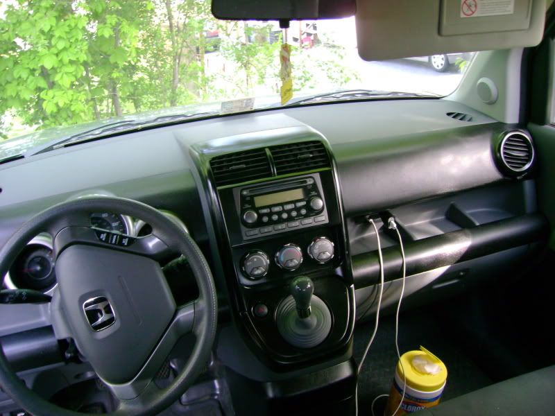

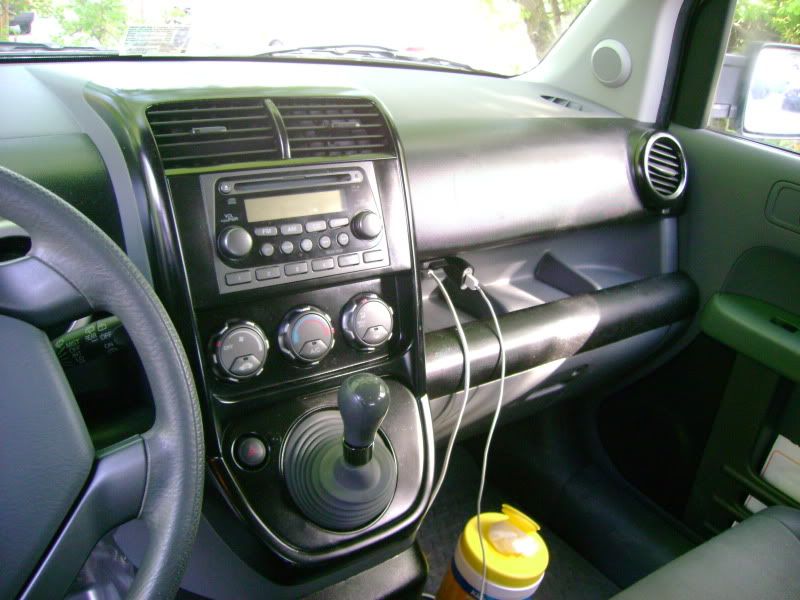

Hello everyone, i joined a while ago but never really posted anything. so here we go!
I finally got around to painting my dash black, used krylon fusion, no sanding or priming, just cleaned with mineral spirits and spayed a few light layers, i think it turn out great!
let me know what yall think

Looks very good...good enough to mae me think of doing the same in fact.

Thanks yall for the feedback, im very proud of myself haha
I want to do the door rests, but i dont wanna mess the wiring up by trying to remove them the wrong way, anyone know how?:)

How easy was it to remove the dash pieces? I was thinking of doing this the other day, and the long weekend might prove to be a good project period.
Any instructions on how to remove them? Could you link me to the specific paint you used?

i started with the air vents on the dash, the side ones, just tug a bit on the open close tab below the vent and it should pop off, then take the side piece of the dash that you can only see when you open the door, they are large triangle shaped, just pop that off with a flat head screw driver and unscrew the screw holding the top textured piece on, same on the other side
here is the type of paint i used, you can get it at home depot, walmart, or most hardware stores. i just got the semi gloss black, and followed the instructions on the can
