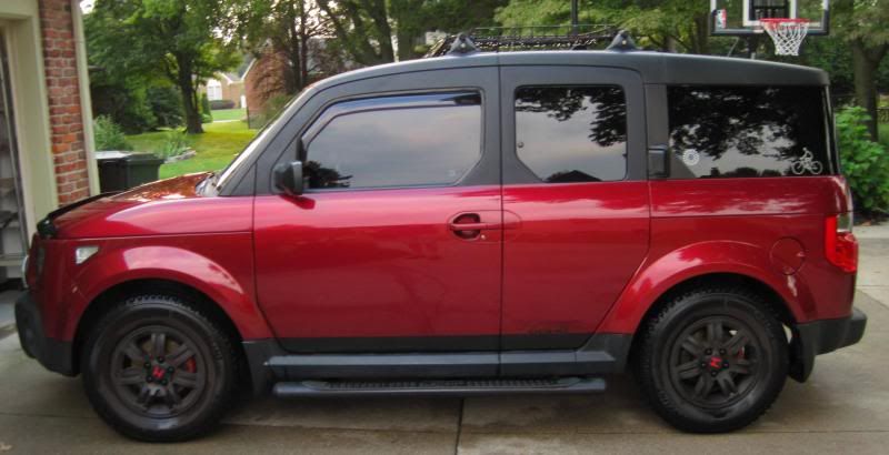

Two tone dip job, I like it. I dipped my wheels and an disappointed, it's started to bubble and peel on 2 wheels and it's only been 3 months. I had read better reports, so I guess I was too hopeful.
406 Posts
How did you manage to get the tape line so crisp?
1,220 Posts
nice... i wanted to dip mine exactly the same way but i wasn't sure how it would look with the plastic panels.
599 Posts
I've got the same two tone RR paint, have thought about dipping the top half like this but had never seen an example. This totally made up my mind.

the crisp lines start there, with a little masking tape, then do the rest, then hit near the tape again, then remove while wet.
also i rolled the front windows down and pulled the weather strip and tucked it away so it didnt stick to the plastidip.
the wheels bubble a couple of times but i cut out the bubbles and just reapplied.

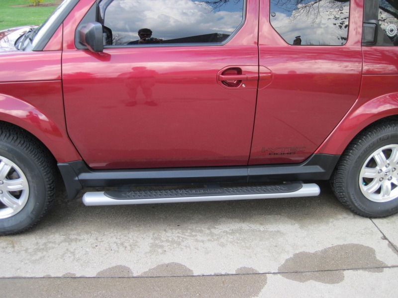

Before plasti-dip:

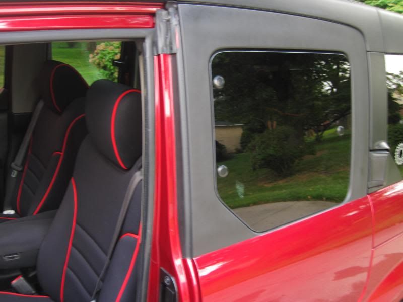

After plasti-dip:
Comparison of plastic and plastidip:
Door jamb (sorry slightly out of focus):
