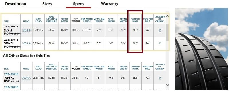

Do you have any issues with the AWD as far as different front and rear tire sizes are concerned?
147 Posts
Almost. The difference is very small, 713mm vs 719mm. I was just curious if you noticed any funny business at that small of a variance.
Not all tires are the same OD even though listed as same "size". The tolerance allowed in tire manufacturing is huge, which is why you only use the calculation as a general idea. Some companies 235/50-19 has on OD as high as 28.4" .... you need to check the specs on each individual tire model.
I chose Dueler sports as both front and rears are 28.1" OD
850 Posts
That is good to know. I was using a tire size calculator and that's the #s it was spitting out.
Your setup looks real clean. Keep us posted on how the custom axles are hold up.
