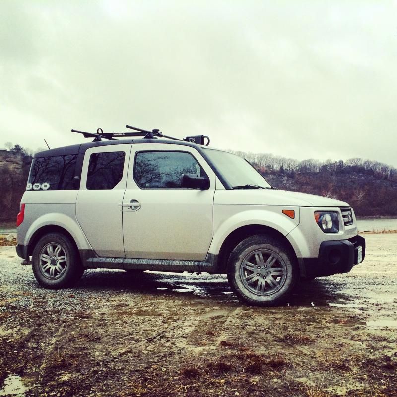

Installed my 2" Reese hitch, yakima holdup hitch rack, and thule/rockymounts roof rack last night. Lovin it! I need to figure out if my thule roofbox will fit into the garage still..but not a huge need for it being on right now with ski season winding down.
34 Posts
Just put my Thule MOAB up on my Thule crossbars and feet.
I bought all this stuff used on CL so the MOAB needed some refinishing.
Also, I mounted it with the brackets upside down so it would sit lower on the roof.
It actually touches the roof just in a couple spots, in fact it scratched up the roof when I installed it. If anyone else were going to do this, I would suggest wrapping those spots in gorilla tape or something cushioned...
