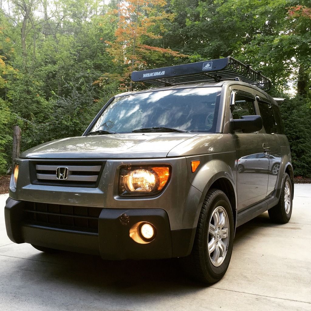

OEM Roof Rack
Yakima Megawarrior with Extension
We tried to use the mounts upside down to make it ride lower but the spaces in the basket didn't line up with the roof fixed points. Going to mess with it some more.

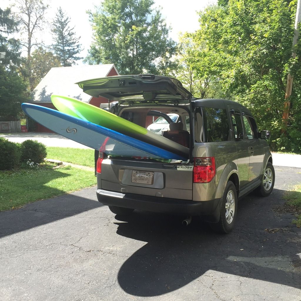

Before I got a chance to get the rack on we found that 11'6" SUP boards fit nicely out the back haha.
