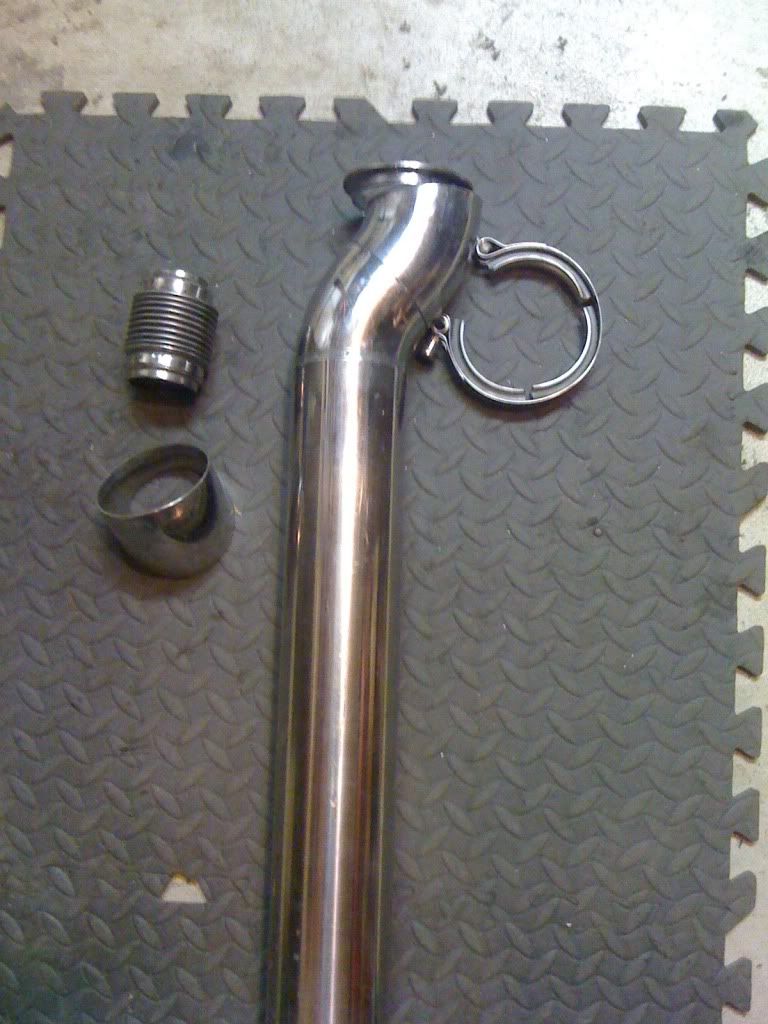

Here's some of the goodies I've picked up so far.
The big tubing is 3.25" and the smaller is 2.0"
everything is stainless
enjoy

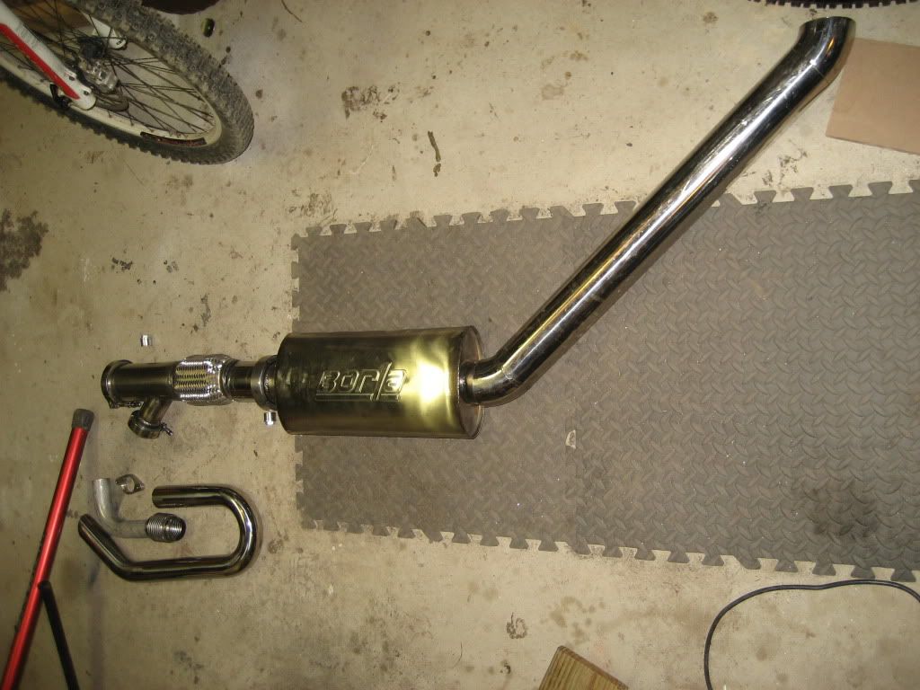

Yeah, 3" Borla xr-1 16" oval case. It's full 304 stainless including the filler mesh. It's supposed to be one of the highest flowing muffler on the market. Should be here tommorrow.

Remember exhaust pipes are measured OD not ID. So yeah I'm hoping they will either butt together or slip together. Either way, nothing a little molten 308 filler can't handle.

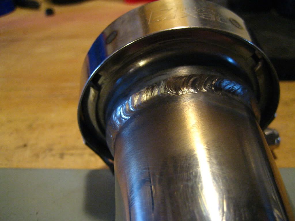

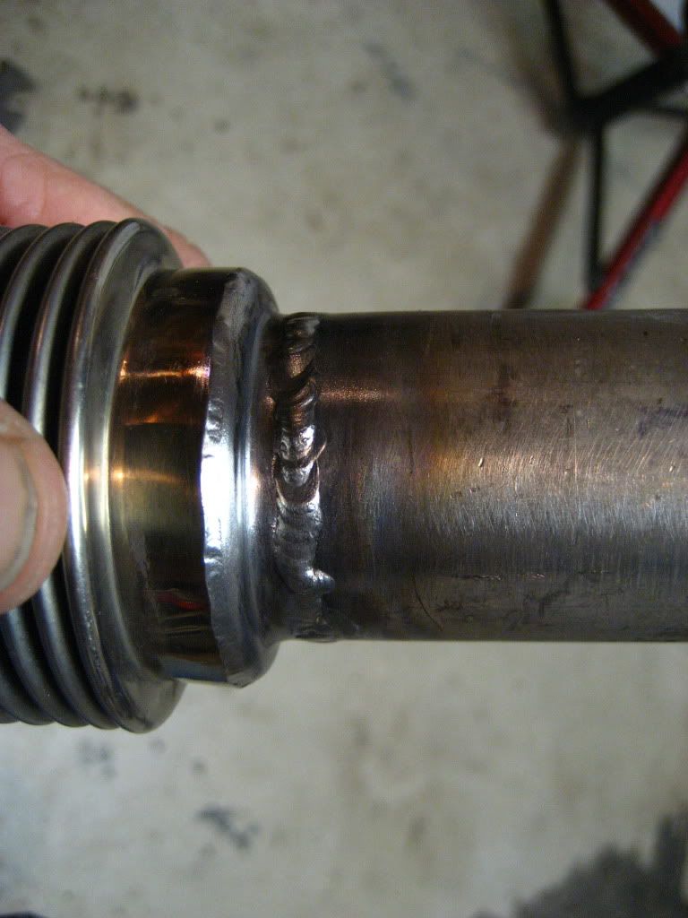

Discussion Starter · #10 ·

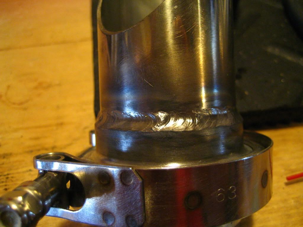

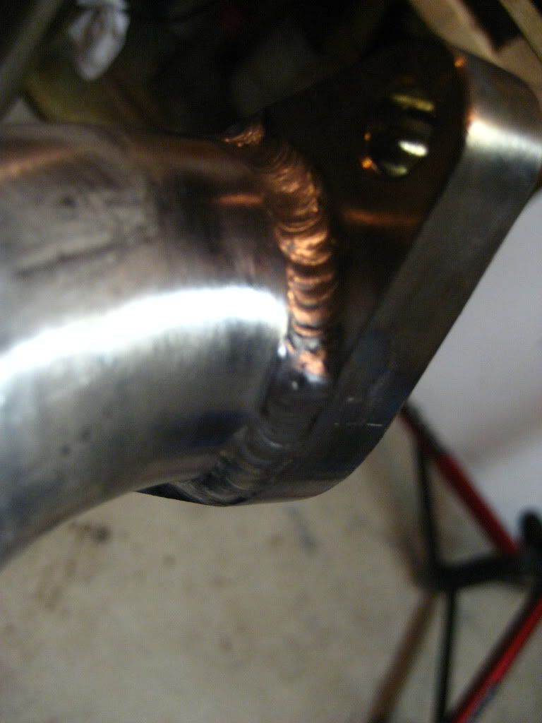

A little but, I learned on aluminum. So steel is easy compaired to that. I actually only did a couple practice welds before I did that piece. The trick is weld hot and fast, use flux inside the welds.

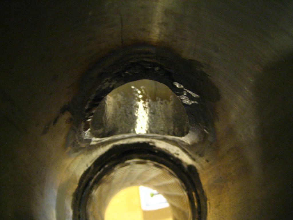

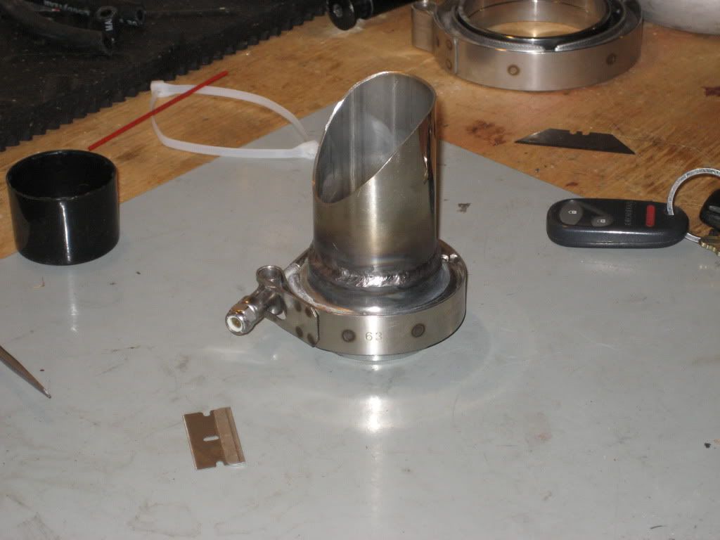

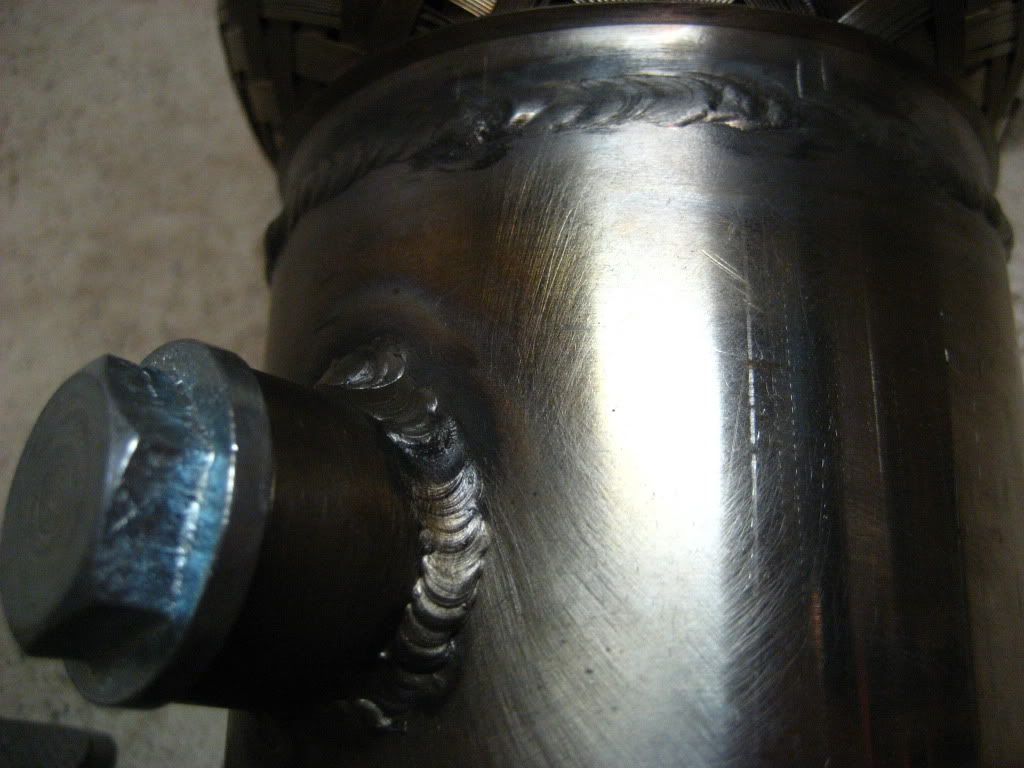

more pictures

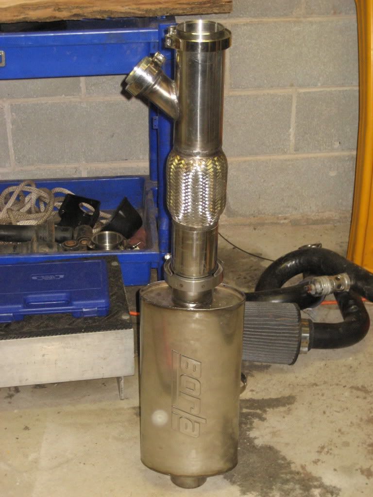

I've been doing a few things in advance because I have to fill my welding tank and it wasn't completely empty yet. I got the Y-pipe where the wastegate will connect finished and welded on the flex pipe. I also ported out the inside of the Y so the exhaust has a smooth transition into the main pipe.
This is still just the basic setup, not everything is welded yet, I just need to visualize the lay out.

it does step down a tiny bit. It's 1/3 optical illusion, 1/3 step down to 3.0" ID, and 1/3 variation in tubing thickness. The shiny stuff I'm using is pretty thick it probably has an ID of 3 1/8"
