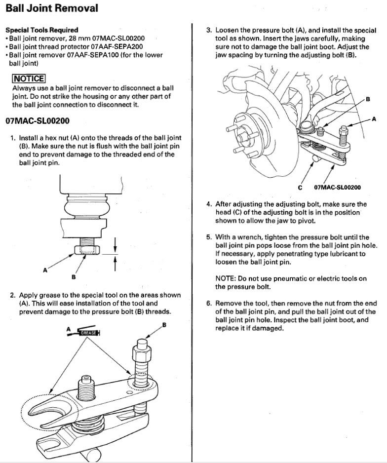

The problem I'm having now is the LCA won't release from the ball joint. I have all the bolts/nuts out but it won't budge. The ball joint doesn't press fit into the LCA does it?
104 Posts
Technically it is a press fit. The ball-joint stud is slightly tapered as is the hole. When you tighten the castle-nut, it presses the stud into the hole and they become locked together. To undo this, you must use a tool called a tie-rod lifter. It looks like this:
It can be rented for free from Checker Autoparts. It's one of the parts inside their "5-pc Front End Service Set". If they say they've never heard of that, tell them to start opening up tool kits to find it. They like to go by the stupid numbers on the kit instead of the name sometimes. And nobody works in those places more than a few months...
To use the tool, you slip the fork part between the LCA and ball-joint boot (don't tear the boot). Then adjust the main bolt till it lower jaw is clamping on the stud. As you tighten the bolt on the tool, the jaw clamps tighter and tighter until the stud pops out (BANG!). Just be careful not to let the jaw slip and damage the threads of the ball-joint. Also, if it seem like it's taking too many turns to pop out the stud, use a hammer and bang on the side of the LCA. The shock should pop the joint loose.

Cool! I'll be going to Autozone to round up this tool when I get back in town. I was hoping to get these changed before I left but it's alot more work than I expected. Not more than I can handle just more than expected.

Autozone does not have this tool. Checker Autoparts does. Ask fort he 5-piece front end service set...

The aftermarket ball joint tools (of the style above) I've seen don't work on the Element; the fork part is narrower than on the 07MAC-SL00200. You might be better off with a Pittman arm type:
Be sure to protect the stud threads with a nut or Honda tool #07AAF-SDAA100.
6,238 Posts
The aftermarket ball joint tools (of the style above) I've seen don't work on the Element; the fork part is narrower than on the 07MAC-8L00200. You might be better off with a Pittman arm type:
2ed^^^
I usually just drop an appropriately sized 1/4 inch socket over the stud to protect the threads.
EDIT : A cheep one I might add !!
It normally takes several hits with a 1 lb. hammer to dislodge it.
In true red neck fashion, I use a piece of chewing gum to hold the socket on the nut, while bashing madly at it! :D
