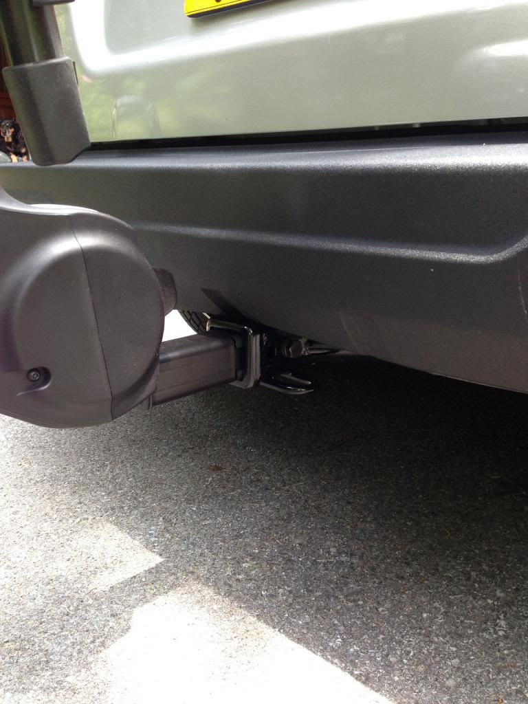

Here are a few of mine. I had seen a few statements by others that to mount it on an 07-08 SC or all 09's and up, that you're supposed to notch the bumper for clearance. I didn't like that so I redrilled tbe rear mounting holes and made a spacer at the back so it would just fit tightly under the bumper without pushing up against it.

Here are a few of mine. I had seen a few statements by others that to mount it on an 07-08 SC or all 09's and up, that you're supposed to notch the bumper for clearance. I didn't like that so I redrilled tbe rear mounting holes and made a spacer at the back so it would just fit tightly under the bumper without pushing up against it. You might have to stare a minute at the photos to ignore the trailer and receiver to appreciate where it all is. You can also hit your local Honda dealer and ask for a trailer hitch plug for a Ridgeline which is a drop-in and is cheap as well!
As you can see in the second photo the hitch is flush with the bumper - doesn't stick out and fits nicely.
