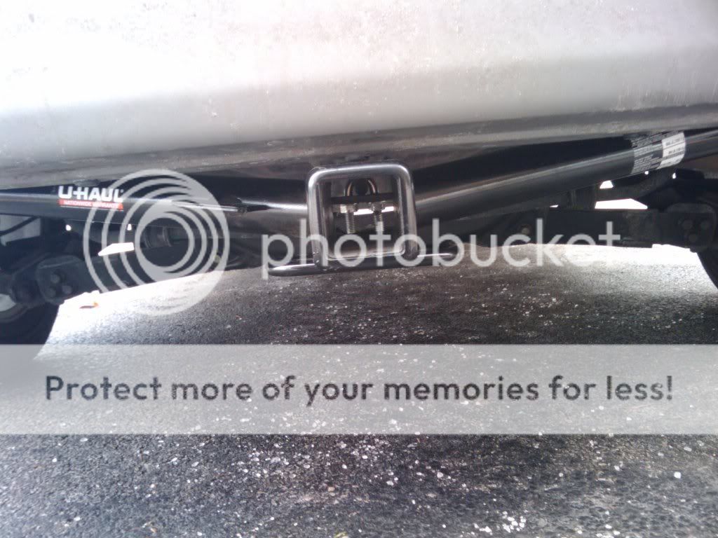

Got my U-Haul trailer class III hitch about a week ago for 135.00$, with wire harnesses about 161.00$. The U-haul guy gave me 353.58 for everything:hitch, wire harnesses and install them. I said i'll do it myself.
And here i am after 1/2 hour job.
I pretty much follow the instructions here http://www.etrailer.com/instructions.aspx?pn=87506 but in different order

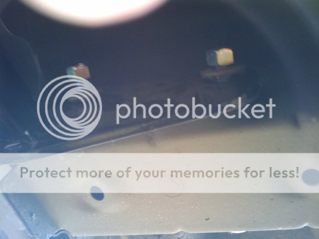

-First istall U-bolt over vehicle trunk pan tie-down hook and down through center hitch bracket.
-Put the 3/8'' hex locknuts on u-bolt and let the hitch hangsjust like in pics. took some pics w/ my phone, not the best quality but u get the idea
-follow the steps 1,2 and 3 from the instructions linked above

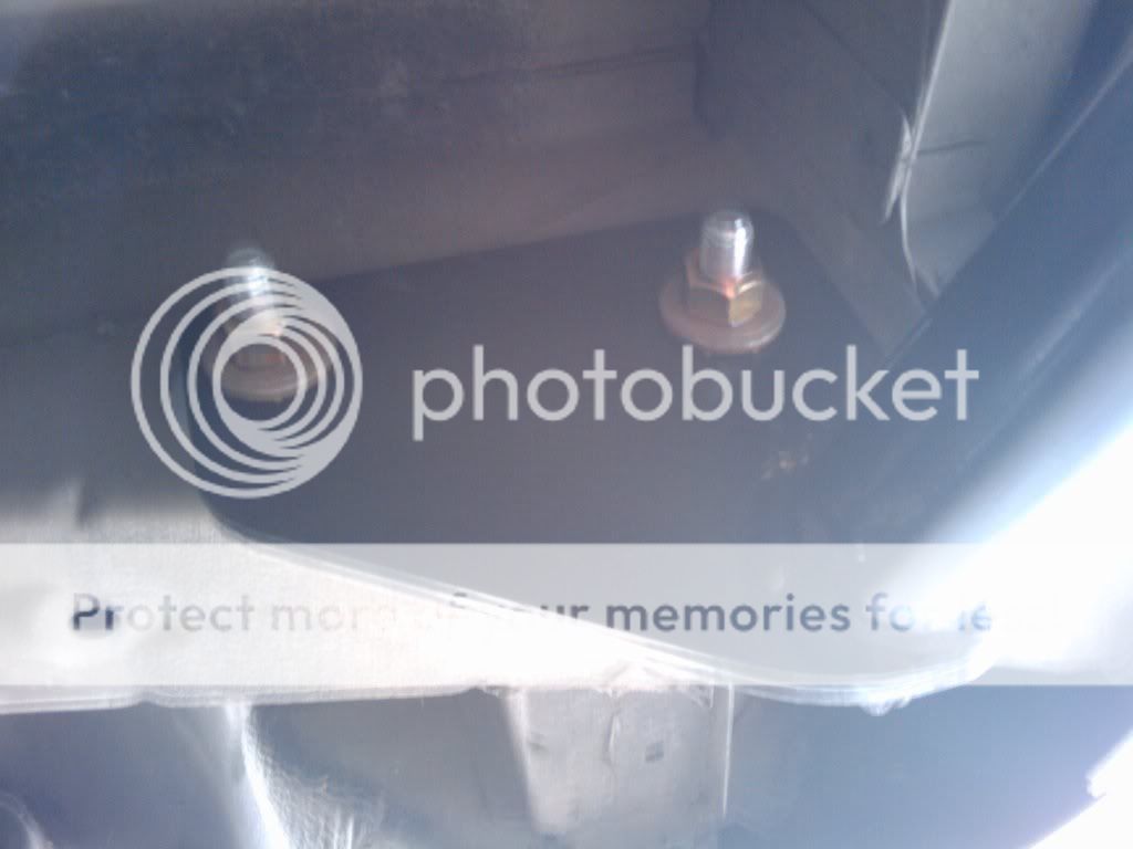

-use red loctite on each bolt
-tighten all 1/2'' bolts
-I tighten u-bolt last , looks like this
Job done

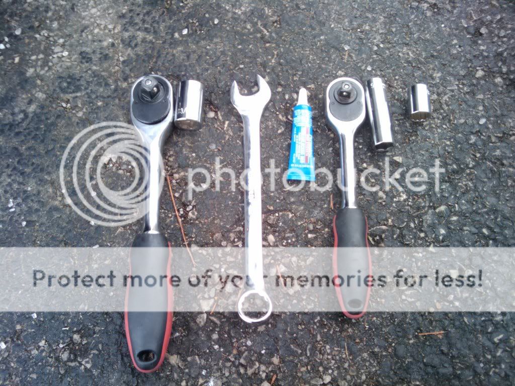

Tools i used :
-1/2'' ratchet
-3/4'' socket
-3/4'' wrench
-3/8'' ratchet
-9/16 deep/regular sockets
- red loctite
That was pretty much all, about 1/2 hour work , do drilling , no hammering.
